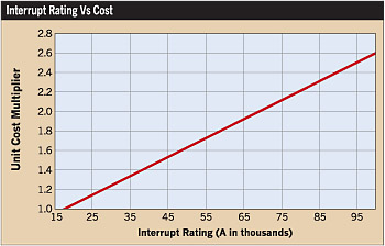

The amount of current available varies from installation to installation, depending on the impedance of the electric source. For example, if the available fault current is determined to be 12,000A, the MCC must be rated to withstand 12,000A of fault current during the time it takes the overcurrent protective device (OCPD) immediately upstream of the fault to open and clear the fault. Fault-current ratings of electrical devices are available in semi-standard ratings. Some typical ratings are 10,000A, 14,000A, 18,000A, and 22,000A.
The fault current withstand rating of an MCC is determined by the lowest rated device within the MCC. If an MCC bus structure is rated to withstand 42,000A and a circuit breaker is installed with a fault-withstand rating of 18,000A, then the entire MCC assembly is rated 18,000A. Bear in mind that most NEMA class motor contactors are rated for a fault-current withstand of 5,000A; some are rated for 10,000A. In order to account for the lower fault-current withstand rating of motor contactors (and avoid costly fault damage), a current-limiting motor protector circuit breaker or current-limiting fuses should be considered.
Bear in mind that the higher the interrupting rating of a device, the higher the cost (Figure on page 18). Therefore, significant cost savings can be obtained by doing a short-circuit analysis of an electric power circuit.
