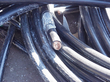

Forget collecting those aluminum cans—salvaging wire and cable is where the real money is. Electrical contractors routinely create scrap metal products such as wire and cable, aluminum conduit, cable tray, copper pipe, and even switchgear on the jobsite, but they may not realize the value of these materials can significantly boost their bottom line. The keys to getting the highest price for these
Electrical contractors routinely create scrap metal products such as wire and cable, aluminum conduit, cable tray, copper pipe, and even switchgear on the jobsite, but they may not realize the value of these materials can significantly boost their bottom line. The keys to getting the highest price for these items are knowing exactly how to collect and sort the material and bringing it to the proper scrap processing facility.

Separate wire by type.
Separating high-voltage electrical cable from low-voltage communications wire allows the scrap dealer to weigh and grade each type of wire based on its copper or aluminum content. Recoveries vary, so keeping them separate takes the guesswork out of measuring the exact weight of each type of conductor. Also separate aluminum and copper wire for processing.
Don't strip insulation from wire.
Stripping insulation by hand is a dangerous task and does not add any value to the wire. Wire value is based on known metal recovery formulas for each type of wire. The insulation is ultimately removed from the conductor by high-speed wire-chopping machines. You can even leave the wire on its spool because the machine will also separate the wood content from the wire. Never burn wire to remove its insulation — it's a wasted effort and could lead to a fine from the EPA.
Remove all contaminants.
The highest valued insulated copper wire, called #1, is copper wire with no other metallic contaminants. The next best classification of copper wire, called #2, contains contaminants such as brass connectors, solder, and plating. Connectors, end fittings, and plated or lead items are worth far less than copper, so, if possible, remove the noncopper items. You can raise the value of your wire scrap by removing these contaminants ahead of time and thereby raise your scrap material from a #2 grade to a #1 grade.
