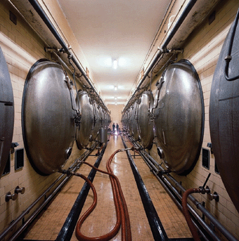

Pin-and-sleeve devices are often the first choice for high-quality, secure electrical connections in high-abuse environments. They are well-suited to supplying power equipment like welders, motor gen-sets, compressors, conveyors, portable tools, and portable lighting. They are especially appropriate for matching high-current power sources to the correct equipment and integrating switched and fused interlock receptacles in wet or corrosive environments (Photo).
