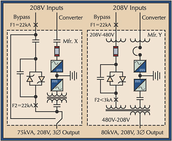

The differences between one manufacturer's designs of the bypass circuit over another can result in a wide disparity in their short-circuit current ratings. To illustrate this point, let's examine units from two hypothetical UPS vendors (see the Figure above). The bypass equipment of Manufacturer X's unit consists of an input contactor, a solid-state switch shunted by a second contactor, and a manual wraparound mechanical switch. Manufacturer Y's unit consists of an input transformer, a current-limiting fuse, a solid-state switch shunted by a contactor, and an output transformer. The Table below summarizes the data for these two units.

You must base the short-circuit rating of the bypass circuit on the component with the lowest rating — or the manufacturer's specified rating — and the large fault current of the alternate source. Let's assume 22,000A rms SYM fault level (designated as F1) at the UPS input. For Manufacturer X, the fault let-through current of the bypass source must not exceed 2,191A rms SYM at 208V on the load side of the static switch. A fault (F2) on the load side of this switch will subject the device to 10 times the short circuit current it can safely handle. For Manufacturer Y, the fault let-through current of the bypass source must not exceed 2,898A rms SYM at 480V on the load side of the static switch. Manufacturer Y mitigated the fault level by introducing an input transformer and current limiting fuses, which reduced the fault current below 2,898A. Therefore Manufacturer Y is good for connection to a supply with an available fault of at least 22,000A while Manufacturer X is suitable for only 2,191A — a ratio of 10:1.
For Manufacturer X, you would need to externally address short-circuit current reduction. The problem of reducing the fault current to an acceptable value to meet the requirements of 110.10, coupled with the goal of complete coordination among circuit protection devices that support mission-critical systems, is the challenge the power systems engineer must overcome to safely power up Manufacturer X's UPS.
