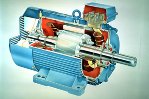

The rotor is another assembly made of laminations over a steel shaft core. Radial slots around the laminations' periphery house rotor bars, which are cast-aluminium or copper conductors shorted at the ends and positioned parallel to the shaft. Arrangement of the rotor bars looks like a squirrel cage, hence the well-known term, “squirrel cage induction motor” (Photo above). The term “induction motor” comes from the alternating current (AC) that's “induced” into the rotor via the rotating magnetic flux produced in the stator.
Motor torque is developed from the interaction of currents that flow in the rotor bars and the stator's rotating magnetic field. In actual operation, rotor speed always lags the magnetic field's speed, allowing the rotor bars to cut magnetic lines of force and produce useful torque. This speed difference is called slip speed. Slip also increases with load and is necessary for producing torque.
