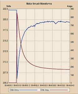

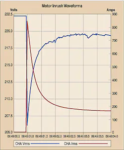

Characterizing inrush currents and their effects requires a monitor capable of capturing the waveforms for a long duration. Figures 1a and 1b show an inrush of current to a motor that resulted in a significant sag lasting more than 1 second.
Ohm's and Kirchoff's Laws can help you analyze what happened. Per Ohm's Law, voltage = current × impedance. Per Kirchoff's Law, the sum of voltages around a closed loop must equal zero. If we assume a 0.5-ohm source impedance and a 10A nominal current on a 480V system, the inrush current can result in a drop of 30V to 50V. Therefore, voltage at the load would sag to 430V, down from the nominal 475V level. This sag occurs because the impedance of the motor initially (when the rotor is stationary) looks much like a short circuit. Once the rotor starts turning, the current decreases and eventually goes to a much lower, steady-state value. However, if a load change causes the motor to come close to stalling or remain in the locked rotor condition, another sag can result for similar reasons.
