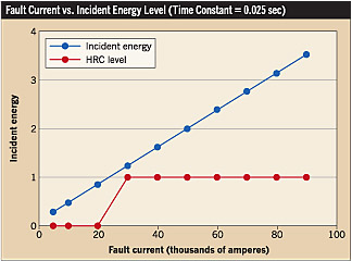

Figures 1, 2, and 3 show just how much time and distance can affect the energy calculations. In Figs. 1 and 2, the working distance is held constant at 18 inches. Only in the last graph (Fig. 3) is the working distance varied. Each graph shows the arc flash energy level on the vertical axis (blue line). The numbers on the red line show the NFPA 70E hazard risk category (HRC) level.
In Fig. 1, you can see the effect of raising the fault current when the device operating time is held constant at 0.025 seconds. This is the typical clearing time of a molded-case circuit breaker tripping instantaneously. As the fault current is raised from 5,000A to 90,000A, the HRC varies from 0 to 1. Therefore, if the device is tripping quickly, raising the fault current does not significantly affect the HRC level. The energy level only rises slightly.
