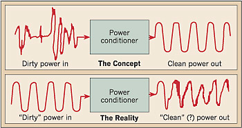

You can view power quality problems as the difference between the quality of power supplied and the quality of the power required to reliably operate load equipment. Using this viewpoint, you can resolve problems in one of three ways: Reduce power supply variations. Improve the load equipment's tolerance to these variations. Insert some power conditioning equipment between the electrical supply and
  • Reduce power supply variations.
  • Improve the load equipment's tolerance to these variations.
  • Insert some power conditioning equipment between the electrical supply and the sensitive loads.
Of course, practicality and economics will determine the extent to which you can use any of these options. This article will focus on the third option.
Source compatibility. Power conditioning equipment must be compatible with the intended power source to ensure its own operation and to avoid interfering with the operation of other loads connected to the same power source.
Along with the obvious considerations (input voltage levels, number of phases, and frequency), you should focus on the following subtle ones:
  • Tolerance to expected sags, swells, and surges.
  • Limited start-up or in-rush currents to prevent voltage sags.
  • Limited harmonic input current distortion.
  • Limited notching.
If you don't, the power conditioning equipment may cause disturbances for other loads. For example, while a static UPS provides interruption protection for its load, its rectifier may produce voltage notches that can cause sensitive loads in the building to malfunction.
Load compatibility. It would seem obvious that any power-applied conditioning equipment must be compatible with the sensitive load. But to ensure this, you need to know the load's requirements so that you can match them with a power conditioner with compatible output performance. For example, if the load's allowable input voltage range is +6%, -10% of nominal, then you don't need a precision voltage regulator to maintain output voltage to within ±1%.
You also must take into account fundamental considerations, such as size, operating voltage, frequency, and number of phases. Sizing depends on the type of conditioner. You size TVSS devices, which are connected in parallel with the protected circuit, according to the maximum expected surge current they may be required to conduct. On the other hand, you must size a voltage regulator to operate and conduct the load's total current.
You would often size the conditioner on the expected maximum continuous full-load current only. But to avoid undesirable load-source interactions, you'll need a more detailed load profile and an understanding of the conditioner's response to the load. A load that experiences large current variations may cause the conditioner's output voltage to vary significantly. So, you may have to oversize the conditioner or select one less affected by load current variations.
Likewise, if the load current is nonsinusoidal, you again may have to oversize the conditioner or select one specifically designed to accommodate the heating effects of nonsinusoidal current without excessive output voltage distortion. Nonlinear loads with high peak currents also require special consideration when sizing power conditioners.
