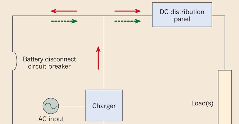

Figure 1 depicts the block diagram of a battery-powered DC system. The main components are the battery, battery disconnect circuit breaker, charger-rectifier, and the distribution board that supplies DC power to the loads, apart from metering and the AC distribution unit. The battery and charger are connected in parallel with the load, meaning they're always online.
Under normal conditions, the battery mode is in standby (secondary) while the prime power source (AC power system) provides electrical energy to the loads. In standby mode, the battery plant does not discharge its DC energy but maintains itself at fully charged condition by consuming a very small amount of DC current. When the prime power source is severed or the flow of rectifier DC power is interrupted, the battery instantaneously becomes the prime source of power for the loads, allowing no interruption of power to the loads. The battery reserve (backup time) usually ranges from 2 to 8 hours and is user-specified in accordance with the specific needs of the facility.

Figure 2 shows a typical telecom DC power system with multi-string batteries and N+1 chargers. The operating scenarios with respect to the battery circuit current are summarized in the Table.

The continuous current rating of the conductor and circuit breaker in the battery circuit are based upon the worst-case current to or from the battery, whichever is higher. This current is determined by analyzing the battery charging and discharging scenarios, as noted in the Table. The breaker trip setting must be greater than the anticipated continuous current. Industry standards suggest increasing this value by 25% to arrive at the protection rating. The conductor ampacity rating is also based on 125% of the continuous current, per NEC Sec. 215.3. However, the continuous current rating of the breaker cannot exceed the final ampacity of the circuit conductor after all the correction factors are applied.
Battery disconnect circuit breaker
For a battery system with two or more parallel strings, when one string is offline and a discharge is initiated, the disconnect breaker for the active strings must be able to support the full system load. Similarly, the disconnect switch must be rated suitably for the charging current when the fully discharged active strings share the full charger output current. However, some designs do not provide for one battery string to be offline for a long period except for a few hours shutdown for routine maintenance, especially for systems with two or three battery strings. In this case, all battery strings are considered “on” for component sizing.
