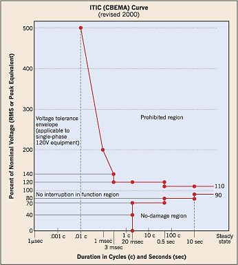

How sensitive is your equipment? The main factor that determines whether voltage sags will affect your facility is the sensitivity of the equipment in your process. The sensitivity curve developed by the Information Technology Institute Council (ITIC) shows that computer equipment should be able to ride through short-duration voltage sags, if the voltage doesn't go below 70% (Fig. 1). For sags of longer duration, voltages below 80% could affect the equipment.
The semiconductor industry developed a recommended equipment voltage sag tolerance curve that specifies improved ride-through for the first 200 milliseconds, which provides substantial benefit for many voltage sags. Figure 2 shows example voltage sags plotted along with the ITIC and SEMI F47 tolerance curves. (SEMI F47 refers to the semiconductor industry standard, Semiconductor Equipment and Materials International, 1999.)
The Table summarizes the expected voltage sag performance for different types of systems, comparing the performance you can expect if your equipment has ride-through characteristics specified by either ITIC or SEMI F47.
