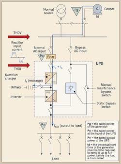

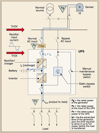

Because an information technology (IT) installation is particularly sensitive to power supply fluctuations and distortions, it typically relies on an uninterruptible power supply (UPS) to mitigate the effects of these phenomena (Fig. 1). Some installations even include a second UPS supplied by a separate feeder and a standby generator that can be set to start automatically 3 minutes after detecting a power interruption. If the risk from weather or other local occurrences is great enough, some facilities will manually switch over to backup generation ahead of time.

This step requires checking and measuring the UPS specification. You'll need two 3-phase power quality analyzers for this — one for measurements at the output and the other at the input. The procedure is to record voltage, current, real power, apparent power, power factor, voltage, and current total harmonic distortion (THD) at both points. Then, vary the loads from 0% to 100% in 25% incremental steps for balanced load testing. For unbalanced load testing, follow the load matrix shown in the Table.
