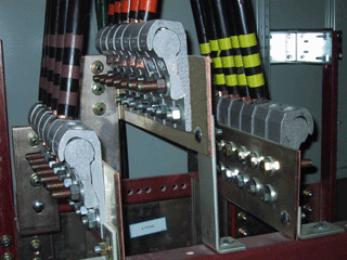

This same concept also led to the design of stored energy connectors for large power cables. A “spring-loaded” connector designed for use with power cables makes sense, particularly where intermittent loads or machine vibration thermal cycling is prevalent or where cold flow is a concern. In addition, the connectors are made of an aluminum alloy, coated with an EC-90 anti-corrosion coating and using anti-oxidant compound to assure compatibility between dissimilar metals.
These UL-approved, stored-energy terminations offer fast termination time using only standard socket tools and end wrenches. When you first insert wire into the opening of this type of connector, 30° of space will separate both halves of the connector. As you tighten the bolt, however, the compression force will bend one of the halves, pinching or holding the wire in place. Most importantly, these connectors always remain tight using interacting levers, which generate a constant, repeatable pressure connection regardless of the electrical currents to which they are subjected. It’s important to note, however, that you still must not over-torque the mounting bolts, which causes them to stretch and lose tensile strength.
Just as with the stored energy wire terminators for small wires, these new connectors for large cables are designed so that a setscrew can’t damage the conductor strands or loosen from vibration. A single bolt securely holds together both pieces of the connector, which are rated at 90°C (see photo, right). The metal-to-metal conductive surface area is under continuous pressure, which assures a low electrical resistance. The constant pressure between the machined lug surfaces minimizes the potential for galvanic corrosion on these important conductive surfaces. Separate bolt hardware secures the lug to the bus bar, using the familiar Bellville washer technology. Since the second bolt can be installed through the lug and the equipment bus bar, the stored energy of the connector can simultaneously assure continuous tight contact pressure between the wire and the lug, as well as between the lug and the bus bar.
To make installations even more rapid and cost-effective, multiple wire lugs are available factory-mounted on a single “power bar” (see photo, right). This eliminates the need for several forms of taps and kerneys, while simultaneously negating the possibility of setscrew loosening, which sometimes occurs with stranded conductors.
