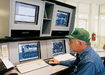

Careful attention to variable frequency drive considerations pays off in major redesign of cement plant. Lone Star Industries redesigned its cement plant with one mission in mind—to increase production (Photo), without compromising safety, product consistency, on-time deliveries, or product quality. Variable frequency drives (VFDs) played a large part in the conversion that enabled the Greencastle,
Lone Star Industries redesigned its cement plant with one mission in mind—to increase production (Photo), without compromising safety, product consistency, on-time deliveries, or product quality. Variable frequency drives (VFDs) played a large part in the conversion that enabled the Greencastle, Ind., cement plant to nearly double its production levels from 750,000 tons per year to 1.3 million tons.
