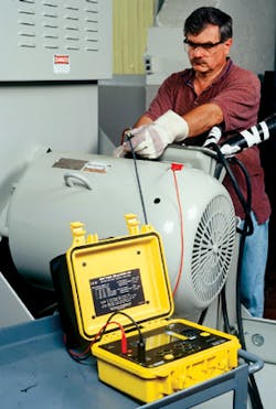

Insulation resistance testing is a simple yet critical preventive measure that can significantly lower your maintenance costs. You may be familiar with the role insulation resistance testing plays in cable maintenance, but do you realize it can help you prevent untimely motor failures, too? Not only is motor insulation susceptible to excessive temperature, moisture, dirt, corrosive vapors, vibration,
You may be familiar with the role insulation resistance testing plays in cable maintenance, but do you realize it can help you prevent untimely motor failures, too? Not only is motor insulation susceptible to excessive temperature, moisture, dirt, corrosive vapors, vibration, oil, and aging, but it must also survive spikes from VFDs and normal inrush current. A consistent insulation resistance testing program provides considerable savings and increases uptime.
Testing also reduces maintenance resource waste. For example, a stamping and assembly plant replaced a 250-hp motor in its plant air system with a rewound motor it purchased from a local shop. After wrestling the motor into place, terminating the connections, and coupling and aligning it, the maintenance crew tried to start the motor, but it wouldn't respond. The motor service shop had mistakenly shipped a similar model that still needed to be rewound. The maintenance crew could have prevented the resulting delay and loss of production with a simple insulation resistance test as a condition of accepting the motor.

Before testing, ground the starter terminal, frame, and motor shaft. If you're testing a DC motor, lift the brushes out. Discharge the field winding by grounding. Then remove the field winding from ground and connect to the (-) line connection on the megohmmeter. Connect the (+) earth terminal to ground. You should also measure the stator winding in a similar manner.
Spot reading test.
Conduct this test only when the winding temperature is above the dew point. Connect the megohmmeter across the insulation of the windings. Apply a test voltage for a fixed period (usually 60 sec). Then take your reading. Use the same duration for all tests for comparable results.
Spot reading is meaningful only when you compare results to stored trends developed from previous tests. A downward trend usually indicates a loss of insulation resistance caused by unfavorable conditions like humidity, dust accumulation, and oil penetration. A sharp drop indicates an insulation failure.
