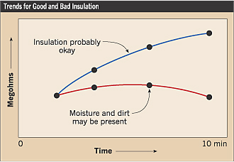

Time resistance test.
Unlike the short time/spot reading test, the time resistance method test can provide fairly conclusive results without the luxury of past test measurements. This test method is based on taking successive readings at fixed time intervals, and then plotting the readings. This is an especially effective method when moisture and other contaminants might be present.
As mentioned earlier, absorption current starts out high and gradually decreases over time as voltage is applied. In a machine with healthy insulation, this trend will continue for several minutes and show an increasing level of resistance. On the other hand, if the insulation is poor, the level of resistance will flatten out after an initial burst (Fig. 1, below).
The best way to quantify the results of a time resistance test is through a dielectric absorption ratio. The dielectric absorption ratio consists of two time resistance readings. A commonly used set of intervals is a 60-second reading divided by a 30-second reading. Another frequently used set is a 10-minute reading divided by a 1-minute reading. This resulting value is referred to as the polarization index. The information summarized in Table 1, below, provides general guidelines for interpreting dielectric absorption ratios.
