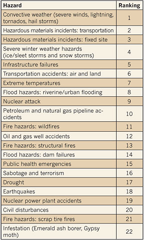

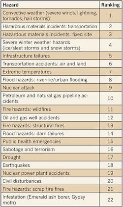

Adopting jurisdictions will now have to prepare and document a risk assessment. As per 708.4(A), “In critical operations power systems, risk assessment shall be performed to identify hazards, the likelihood of their occurrence, and the vulnerability of the electrical system to those hazards.”
As with other NFPA documents, such as NFPA 110, “Standard for Emergency and Standby Power Systems,” which requires a written log of generator testing, technical committees assume that mandatory documentation forces facility managers to do certain things that would not otherwise be done if a written record were not required. Local public safety organizations may find that just putting people around a table to do a risk assessment adds value to existing, everyday routines — not just during times of operational discontinuity.
One simple method of producing a risk assessment is as follows:
A) Identify control boundaries of the system. Is the facility stand-alone or part of a multi-function building? For example, is it shelter in place, off-site, or system + system?
B) Identify every conceivable disaster for the facility and location. Examples appear in Sec. A.5.3.2 of NFPA 1600, “Standard on Disaster/Emergency Management and Business Continuity Programs.”
C) For each disaster, determine a relative probability (1 = less likely; 5 = more likely). This stage may entail research specific to location, industry, and other organizational characteristics.
D) Assess the business impact of each disaster (1 = moderate; 5 = severe). Consider the effect upon public safety officers, hazardous material handlers, dispatch personnel, etc. — anyone who would be involved in disaster recovery functions.
E) Assess your ability to respond to each disaster in light of resource availability. Does your organization have the requisite resources either in-house or through third parties? (1 = sufficient resources; 5 = absence of resources).
F) Calculate a rigorous risk assessment for each disaster by multiplying columns C, D, and E. Normalize the figures, and rank accordingly.
An example of one county's risk assessment appears in the Table above.

Sample risk assessment from the emergency management division of Washtenaw County, Mich. Note that earthquakes in southeastern Michigan are ranked relatively low and that infrastructure hazards are relatively high.
