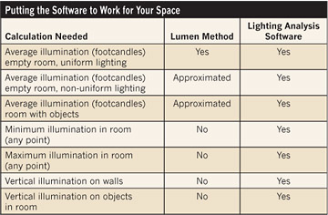

For interior spaces, it's tempting to do simple, lumen-method calculations and be done with it. You can perform the lumen method using a handheld calculator or simple spreadsheet. As long as the lighting system is uniform, the space is a simple “box,” and there are no significant objects in the room, lumen method calculations might suffice. However, if you're following IESNA recommended practices, lumen method calculations just aren't enough for most spaces. As it turns out, lighting analysis software is now an essential tool for even basic lighting designs (Table).

Whether you're dealing with an indoor or outdoor space, there are three basic steps to performing computer lighting calculations.
  1. Provide information that describes the room or space. Most software accepts .dwg and .dxf drawings, but that's generally not the easiest method. Most of the time, it's faster and simpler to use the software's basic CAD-like tools. You'll need to include the length, width, and height of the space. For interior lighting, you'll also need the reflectance of the walls, floor, and ceiling.
  2. Provide information about the luminaires and where they go. Luminaire photometric data is readily available on most lighting manufacturers' Web sites, and the lighting software makes it fairly easy to indicate the location and orientation of each luminaire.
  3. Decide which analyses you want performed. For instance, you can specify a footcandle calculation for the whole space — or for just a particular area of interest.
