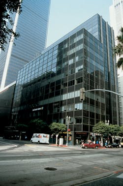

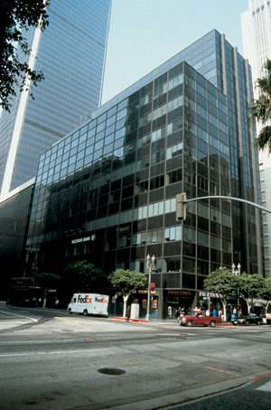

A power upgrade presents both pitfalls and opportunities for EMF mitigation measures. The plan was simple: Upgrade the electrical power delivery system of an aging 20-floor commercial office building located in a prime downtown Los Angeles location in hopes of attracting high-tech tenants particularly telecommunications companies (Photo). However, the engineers were forced to confront a problem that
The plan was simple: Upgrade the electrical power delivery system of an aging 20-floor commercial office building located in a prime downtown Los Angeles location in hopes of attracting high-tech tenants — particularly telecommunications companies (Photo). However, the engineers were forced to confront a problem that has become increasingly prevalent on such projects: electromagnetic interference. As offices are flooded with a deluge of computers, faxes, and printers, the location of electromagnetic field (EMF)-producing power equipment, such as transformers, switchboards, and power cables, and their proximity to those electronic devices are design considerations that can no longer be overlooked.
