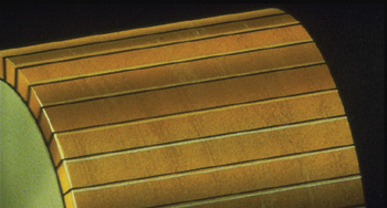

Common commutator wear patterns. It's relatively easy to judge DC motor performance by looking at the commutator. During normal commutation, brush current vaporizes some copper molecules, depositing a uniformly tan to charcoal-brown copper-oxide film (about 2 in.310-7 in. thick) on the commutator. Faint charcoal streaks along the brush paths (Fig. 1 above) may also indicate normal commutation. Even a heavy film coating isn't necessarily cause for alarm, particularly if no areas are unusually dark or worn. The following three conditions demonstrate what can happen to a commutator that has been neglected.
