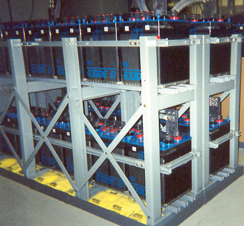

Installation steps.
Assemble the battery rack according to manufacturer's instructions and anchor it to the floor. Verify that dimensions, aisle widths, and clearances are adequate for maintenance access. Place cells onto the rack or cabinet, starting in the center of the bottom row and working outward. Be careful, though, because you can damage the posts if you use them to carry the battery. You'll probably need a mechanical lift to get the cells from the pallet onto the rack. Follow the manufacturer's recommendations for sliding cells on a lifting table or rack, but don't use oil or grease that isn't specifically approved for that purpose. Note that on many seismic applications, you must install spacers between each cell.
The battery manufacturer should supply a layout or connection drawing. Make sure you set the cells so they connect in a series — the positive of one cell connects to the negative of the next. You can verify that all cells are truly connected in series by reading the voltage of one cell, multiplying this by the number of cells in the system, and comparing this to the overall voltage. A 4V discrepancy indicates one cell is installed backward.
Neutralize any spilled acid on cell covers with bicarbonate of soda, and remove any grease from the cell post with a rag or paper towel. Don't use degreasers or solvents.
Polish the post and intercell connector with Scotchbrite, a brass bristle brush, or approved equivalent. If in doubt, ask the manufacturer. Don't use a wire brush, as this may damage the protective lead plating on the copper connectors.
After applying a light coating of NO-OX grease or a manufacturer-approved equivalent to the post and intercell connector, assemble and install the intercell connectors and bolts, and torque them according to the manufacturer's instructions. But be careful: Bolt torque is always in in.-lb, not ft-lb. Once you've finished the installation, read and record the intercell connector resistance from one cell to the next using a micro-ohmeter. This verifies that all intercell connectors are properly installed. You'll need this baseline data for all future maintenance checks.
You can now connect the battery to the system and start the freshening charge. Battery manufacturer's instructions give voltage and time values to assure the battery is fully charged, and to compensate for any charge lost during storage or transit. After the freshening charge is completed, adjust the battery to its proper float voltage. This is usually 2.25V per cell for VRLA and flooded calcium and 2.17V per cell for antimony type. Refer to the manufacturer's instructions. Read and record all individual cell float voltages, specific gravities, intercell connector resistances, and internal cell resistances. You'll need all of these readings for future maintenance.
