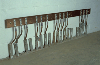

A good reliable protection system requires effective bonding and grounding. These two separate requirements, make up a single critical system.
As defined in BICSI's manual, bonding refers to the electrical interconnection of conductive parts designed to maintain a common electrical potential. You must size bonding conductors to be of sufficient gauge to carry anticipated fault current. Grounding refers to the electrical connection of telecommunications hardware to an effective electrical ground, which can be the vertical down lead of a power system multiground neutral (MGN), a grounded neutral of a secondary power system, or a specially constructed grounding system.
All exposed telecommunications cables that contain metallic components such as a metallic shield, metallic strength member, or metallic pair require some form of electrical protection at the building entrance. It's critical that you connect the metallic sheath components and metallic strength members of all cables entering the building to the telecommunications main grounding busbar (TMGB), which is the location where all grounding conductors must be connected to the earth electrode.
You should also bond all cable shields at all splice locations as well as to the strand of aerial cables. And you should bond all buried cables to ground rods or an MGN. Remember, no system is properly grounded if you fail to properly tie it into an effective grounding system.

When it comes to qualifying your system, check your continuity. Bad connections, broken ground wires, and ground rods improperly placed or installed in a high resistivity soil will create fallible systems.
Visual inspections may not always reveal these problems. That's why you should use test equipment to verify your ground system is intact. Every component of the system must be intact and well bonded to provide proper protection. Unfortunately, continuity weaknesses are found to be the source of equipment damage, electrical noise, or injuries only after the fault is introduced. Most of the time these situations can be prevented with proper design, inspection, or test methods.
