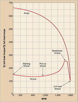

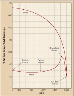

Prior to the advent of the adjustable-speed drive (ASD), the polyphase induction motor operated as a constant-speed motor. Figure 1 shows the well-known torque and current curves versus speed for the motor, where the operating speed is close to 1,800 revolutions per minute. By comparison, Fig. 2 on page 22 shows the torque-speed curves for a polyphase induction motor operated in an ASD over the frequency
Prior to the advent of the adjustable-speed drive (ASD), the polyphase induction motor operated as a constant-speed motor. Figure 1 shows the well-known torque and current curves versus speed for the motor, where the operating speed is close to 1,800 revolutions per minute. By comparison, Fig. 2 (click here to see Fig. 2) shows the torque-speed curves for a polyphase induction motor operated in an ASD over the frequency and speed range of 10% to 160% of base frequency and speed. In addition to being supplied with voltage and current with a sinusoidal waveform, the induction motor in the ASD can also be supplied with waveforms such as those shown in Fig. 3 on page 22, as generated by the inverter of the ASD.
