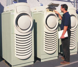

Microturbines also hold promise in distributed generation applications. These smaller cousins of the full-size turbine generator generate as many as a few megawatts in parallel systems and can be located very close to the actual load or on-site at the customer's facility (Photo on page 26).
Today's microturbines are quiet, small (a 30kW turbine is roughly the size of a refrigerator), operate on most fuels, are practically pollution-free, and require only a fraction of the maintenance of a large diesel engine. One day, microturbines may be commonplace in neighborhoods for peak shaving, or in some cases prime power for commercial customers who may not want to contend with outages associated with a utility network.
