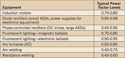

Determining the PF correction needs of plant loads. Before investing in correction devices, you'll first need to know the PF of your facility. The Table above will help you determine a rough estimate. The summary of typical PF levels for various industrial loads will give you a general idea of how much PF correction you may need, but monitoring at the service entrance and on circuits with a potentially poor PF will help you to better identify your facility's requirements. It will also allow you to target the locations that could benefit the most from the PF correction.

Based on the loads in your system and some information on your utility bill, you can calculate the necessary amount of capacitance to raise your power factor to an acceptable level. Review at least a year's worth of your bills to characterize seasonal variations and long-term trends in your loading. The key data are maximum demand, power factor, typical energy usage, and power factor penalty or demand charge.
