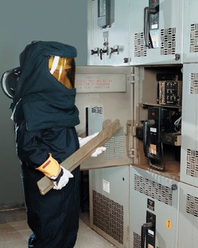

These equations or tables will most likely yield a requirement for Hazard Risk Category 2 PPE while working in downstream electrical panels. Category 2 PPE is designed to protect workers from the onset of a second-degree burn for exposures up to 8 calories per centimeter-squared. As a reference point, the heat exposure to the skin of 1 calorie per centimeter squared is roughly equivalent to holding a lighted match 1 inch from your finger for 1 second. Typically, Category 4 PPE (40 calories per centimeter-squared) is required only at the main cubicle of a 480V unit substation and for medium-voltage circuits.
Category 4 PPE is very unwieldy and can be costly in terms of time taken to perform work. It can also introduce added safety risks, such as heat stress. In addition, personnel are more prone to make mistakes working in restrictive safety clothing. For these reasons, successful completion of an arc flash hazard study represents only the beginning of the work.

Four pilot sites were selected for the initial effort — Pulaski, Tenn., Memphis, Tenn., Bowling Green North, Ky., and Bowling Green South, Ky. In many cases, current information of the existing electrical systems was either incomplete or not available, so the first step involved identifying the location of each electrical panel. Data from circuit breaker nameplates, including existing settings, fuses, and conductor sizes/lengths, was collected for the entire facility. Standard templates were used to record the data, and each plant required a two- to three-day period for all data collection. Because collection of data required opening all electrical panels and exposing personnel to potential arc flash hazards, the field engineer assigned to gather the data was deployed with the appropriate PPE. Much of the data gathering effort was completed during an electrical outage to assure the safety of all involved.
