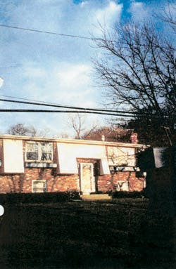

At first, the problem seemed easy to fix. The worker was instructed to raise the telephone and TV cables so that the project could proceed. The plan called for him to temporarily pull down the electric utility neutral conductor and tie it together with the telephone and TV cables using a rope, similar to a previously made tie as shown in the Photo at right. The crew agreed that the quickest way to reach the cables and perform this task was to use the front-end loader as an elevator and lift the worker off the ground and up to the cables and conductor.

Assessing the scene. A review of the scene revealed that a single, bare-stranded 7.96kV primary conductor was located at the top of the utility poles in the span in question. Below this single-phase conductor was a single, bare-wire neutral conductor. The neutral conductor was connected to grounding wires only at the utility poles that were equipped with overhead distribution transformers. The poles with transformers were typically spaced at a three-pole interval. This is a standard design configuration for most electric utility distribution lines. It was also noted that the telephone company owned the utility poles.
A post-accident inspection by OSHA personnel confirmed that the TV and telephone cables didn't meet the vertical clearance requirements stipulated in Table 232-1 of the National Electrical Safety Code (NESC). A mid-span vertical clearance measurement at the site of the accident was found to be approximately 11 feet. The clearance requirement as outlined in Table 232-1 of the NESC is 16 feet.
