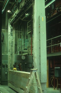

Fire-resistive barriers specified in the second method above include many forms of construction. It's significant to note that the entire wall assembly or floor-ceiling assembly is rated and not a component of the assembly, unlike a ceiling membrane or a layer of gypsum board. The fire test method used to establish these fire resistive ratings for building assemblies is defined in three standards: UL 263, ASTM E119, and NFPA 251. The testing method and acceptance criteria in each of these standards are essentially equal.
Each of these fire test standards limits the temperature rise and prevents flames on the surface of the assembly away from the fire for the rating period. However, they don't limit the temperature within an assembly, nor do they prevent flames within an assembly.

A fire resistive assembly's ability to resist impact loads is determined by the application of a water hose stream (Photo 2). With respect to the resistance to impact loads, the performance of the 50 millimeters (2 inches) of concrete enclosure is evident.
The test standards associated with the second method require that a hose stream be applied to 1-hour rated walls after a minimum 30-minute fire exposure, but no hose stream is required to be applied to floor-ceiling assemblies. When the third method is used, the UL test procedure requires a hose stream to be applied after the rating period.
