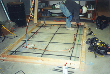

Installation standards. Establishing equipment seismic capability is the first step toward certification. The next step is ensuring the installation methods meet certain standards. For example, you must anchor equipment to the building foundation in a way that prevents or minimizes damage during an earthquake. Improperly attached equipment can overturn or become so flexible that it shears the attachment devices and slides off its foundation. The embedded concrete anchors or steel attachments must be adequate to resist the forces established by the UBC.
Equipment manufacturers provide mounting recommendations based upon shaker table tests used to verify the seismic design of switchgear. These tests prove that a piece of equipment will continue to function after a seismic event. The equipment must be easy to reset soon after the event and keep its structural integrity. This doesn’t mean that circuit breakers and relays won’t trip offline during an event. Switchgear must have this capability for third party testing labs to give it a seismic certification.
A structural or civil engineer responsible for providing the correct attachment method. Manufacturers provide bolt-down locations and other mounting recommendations. The engineer then designs the type and depth of anchors, and suggests additional mounting requirements for the seismically certified switchgear.
The final step is a review of the electrical connections within the system. The designer must specify suitable interface methods. Bottom entry of conduits is the recommended method for switchgear and transformers, because the bottom will sway less than the top. For top entry, you may need to use seismic fittings or flexible conduit. You can use flexible bus to connect generators to busway, and insulating boots may improve the integrity of these installations.
