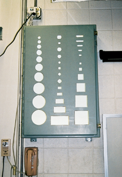

Step one: Locate and mark the hole. Before you can start the hole, you must decide where to put it, but you also need to somehow indicate where that hole is going to be. This may not sound very complicated if you're putting only one hole in a panel, but what do you do when you want to make a row of six different-sized holes? And what if no two are shaped the same? What if you have to modify an enclosure in the field so it looks like the enclosure in Photo 1 above?
The first thing you must do is determine the clearances between the device bodies. It's critical to allow room for a maintenance person to remove and re-land wires. The best way to do this is by laying the parts out on a bench or other suitable surface. If you don't have the parts yet, review the drawings carefully. Once you know the minimum distance between the various devices, you can decide how many rows and columns you want, and what kind of layout works best for the operator. Be sure to leave room for labels on the finished surface so operators can readily identify indicators, switches, and whatever else you're mounting in the panel surface.
Many electricians will work from the back of a panel surface to avoid marring the finished surface, but this technique can cause other problems, especially if a panel is already mounted in the field. Avoid those problems by applying white shelf paper to the finished surface and then work from the front. You can peel the paper off when you're done, and you'll have no marks to clean up. It can also provide some protection against accidental scratching. If you mark all of your holes on the paper before making holes, you can see your layout before it's too late to change it. If you don't like the layout, you can peel that paper off and start over with a new piece. But remember, even if you like the layout, your customer may not — so this provides you with both an easy way to show what the panel will look like and an opportunity to get any feedback while changes are still inexpensive to make.
