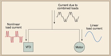

First, you must determine the magnitude of harmonic distortion at different points in the electrical system, and identify whether or not any equipment failures or malfunctions are the result of these harmonics. You can measure the magnitude of harmonics for existing systems by using owned or leased harmonic measurement equipment, or calculating it for proposed systems or additions to systems. Take measurements at the secondary side of supply transformers and generators, as well as at the input conductors for large power electronics loads and at the input to sensitive equipment.
The waveforms and harmonic spectra for current will appear different for measurements taken at the power source, which feeds multiple loads, than for individual loads. For an individual linear load, such as a motor, the current waveform should appear to be a sine wave, whereas it will appear distorted for an individual nonlinear load (Fig. 1). The distortion of individual nonlinear loads will vary somewhat, depending on several factors such as source impedance, load current, and system voltage distortion. The waveform measured at the common power source will result from the combination of all of the individual loads.
The mixture of linear and nonlinear loads operating from a common power source has a significant effect on the distortion present on the electrical system. In cases where mostly linear loads are connected, pure sinusoidal current can overwhelm the system with fundamental current, causing the harmonic current to have less of an effect on the overall system. A system with predominantly nonlinear loads will exhibit a more distorted waveform at the power source.
