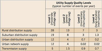

Utility power quality characterizations and predictions. EPRI's Distribution Power Quality (DPQ) data can be used to determine what factors contribute to affecting voltage sags and momentary interruptions. In addition, many utility companies have installed their own power quality monitoring systems that can be used to predict utility system power quality. Other sources of utility power quality data can be combined to provide a summary of the level of power quality of the utility supplies. The Table shows typical supply power quality levels.Step 3. The final step combines Steps 1 and 2 into a single analysis, which is presented in a spreadsheet. At the same time, this step handles the complexities of redundant systems better than some complicated methods, especially with respect to common-mode failures.
