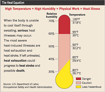

Identifying and treating heat illness. If the body is unable to reduce its core temperature through sweat, it will begin to store heat. When this occurs, the risk of serious health hazards is present. Heat-related illnesses vary in severity, but even a mild case is a good indication that factors necessary to cause more serious problems are present.

Heat stress is 100% avoidable and preventable as long as you recognize the signs and take proper precautions. Remember, you don't need to be working outdoors or living in a warm climate to be exposed to the hazards of heat stress. When the heat index rises above 80° preventable measures need to be taken. By understanding how your body controls temperature you're more able to recognize the symptoms of heat stress. Take immediate action if you or a co-worker develops heat cramps, heat exhaustion, or heat stroke. Use engineering controls whenever possible to reduce the hazards, and allow your body to acclimate to warmer temperatures before you overexert yourself.
