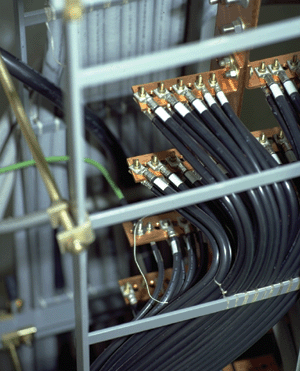

For electrical workers, installing a standard grounding system is almost an afterthought — drive two ground rods and you're done. But this is inadequate for today's applications because it creates the potential for unreliable operation and exposes owners to large financial losses.
The requirements for ground resistance levels are more stringent because of the lower operating voltages and higher operating speeds in today's electronics. For example, telecommunications specifiers want an earth resistance of less than 5 ohms, which is less than half the resistance considered high-performance a few years ago. Specifications even vary among industries — some manufacturing processes and medical applications demand less than 3 ohms resistance to earth. We're even seeing “less than 1 ohm” in some specifications.
However, high-performance grounding is more than achieving a low earth resistance. A high-performance ground gives predictable, long-lasting, seasonably stable performance — and it's testable. Testability is important because grounding systems degrade, and damage to them may not be apparent until a catastrophic failure occurs.
The only way to achieve a high-performance grounding system is to engineer it. This allows you to achieve your desired goals without expensive overkill. In other words, an engineered system gives you what you need at the right price.

Several electrode types are available. Initial low cost, familiarity, and availability make the copper-clad driven rod a common choice. However, driven rods can have short lives and provide unstable performance. Although the NEC still allows you to use infrastructure components like buried water pipes and building steel as ground electrodes, you can't test them and you can't depend on them in a high-performance ground system (see Sidebar above). Further, the ground path they provide is often a shared lane for noise and transients. Other choices include plates and UFER grounds, but plates are unstable and UFERS are typically not testable.
It's beneficial to consider self-activating, electrolytic grounding systems as well. A 2⅛-in. diameter copper cylinder has better energy-handling capability than conventional driven rods and the electrolytic action dispenses a highly conductive solution that improves performance and provides seasonable stability. At least one such system provides high conductivity (60 ohm-cm resistivity), neutral pH, and moisture retention capabilities.
Bonding vs. isolation.
Some people install isolated ground points in the earth without bonding them to the rest of the facility grounding system, which is dangerous because it creates a potential between electrodes. The myth of the isolated ground as a requirement for sensitive circuits violates the NEC, Ohm's Law, and Kirchoff's Law. An unbounded electrode creates a difference of potential that can damage equipment or electrocute someone.
Bonding allows charges to equalize between objects or surfaces, eliminating the voltage potential between them. Electricity wants to return to the source, so without a bond, the potential increases until the electricity can flow through whatever is between it and the source. Even one bonding error can cause circulating loop conditions, shared noise, and an unpredictable, unstable, and untestable ground system. Remember, lethal, undesirable current doesn't distinguish equipment from people.
