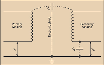

Q. Can shielded isolation transformers provide power conditioning? Designers of electronic instrumentation and data processing systems have made recommendations for their installation, but I'm not sure about their effectiveness.
DeDad's answer. Shielded isolation transformers aren't true power-conditioning devices because they can't adjust their output voltage to compensate for sags or surges on the input line. Nor can they protect your system against voltage spikes of subcycle duration. To accomplish the latter, you would need to add surge suppressors to the system.
Instead, isolation transformers are “noise rejectors” — they provide good electrical noise isolation. Most of the noise currents that couple onto victim communications cabling are common-mode type. This noise can corrupt the communications signals sent by the equipment connected to the cable ends. In extreme cases, these noise currents can be disruptive enough to cause electrical damage, such as component burnout to circuit elements used at both ends of communications cables. The industry expresses achieved common-mode noise attenuation either as a ratio (Vti/Vto) or in decibels (dB) (Figure above and Table at right). Typical applications of isolation transformers include protecting critical loads, such as computers, electronic instrumentation, and data process peripherals, from electrical noise.
Isolation transformers can be designed with a 1:1 ratio, for isolation only, or to provide voltage transformation. While unshielded transformers use capacitance coupling between the primary and secondary windings, a shielded isolation transformer uses primary-to-shield capacitance. It also uses the shield-to-secondary capacitance resulting from the small electrostatic field around the shield. The primary-to-shield capacitance conducts most of the transient energy to ground so the effective capacitance between primary and secondary windings of a shielded isolation transformer is much less than that of an unshielded transformer.
