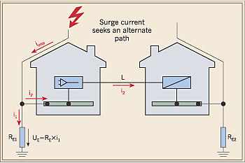

Direct/galvanic coupling. An example of how direct/galvanic coupling affects data lines is when lightning strikes directly to or close by a building or facility (Fig. 1). Due to the resistance of the conductors, the sudden high current to the grounding system leads to a rising of the ground potential itself, which influences the shield of data cables.
The signals on shielded twisted pair (STP) or unshielded twisted pair (UTP) cables are differential signals, and the rising ground potential can damage the susceptible equipment at the other end of the line. The surge protection device (SPD) will protect the susceptible equipment by clamping the voltage under a critical value.
