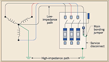

Back to basics. The first thing to understand is that ground-fault current — like all electricity — seeks to return to its power source. This principle is what makes electrical circuits work in the first place. What's the source of ground-fault current? It doesn't originate in the earth, but at the utility transformer.
Kirchoff's Law states that current will flow in inverse proportion to the impedance of the paths presented to it. Thus, the relative impedances of the various paths determine how fault current gets back to its source.
The impedance of the path between the grounding electrode and the source is almost always significantly higher than the impedance of the path through the grounding/grounded conductor.
If you're unsure about this at your facility, measure the impedance of a copper wire from the electrode to the source and compare it with the impedance through the earth.
This difference in impedance means only a minute amount of fault current flows through the grounding electrode. The fault typically travels along the equipment ground (conductors and metal raceway systems), through the neutral-ground bond, and back to the source through the grounded (neutral) conductor. It's the high fault current through the low-impedance path that causes an overcurrent device to trip — not the negligible amount of current that flows through the dirt via a ground rod (Fig. 1).

Main bonding jumper. The main bonding jumper is the link between the neutral and the equipment ground bars within the service. This vital connection allows the ground-fault current to return to the source. Without the main bonding jumper, the fault would have to travel through high-impedance earth rather than low-impedance copper. This high-impedance path would most likely limit the current and prevent circuit breakers from tripping — or at least prevent them from tripping soon enough to avoid equipment damage.
