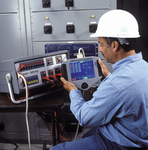

Test equipment. Protective relay test equipment has dramatically changed over the last several decades, especially in the area of AC test current generation. It has evolved from resistive loading to transformer loading to today's electric-grid-independent electronic test sets. Some companies still use transformer loading, but its popularity has decreased since the advent of the electronic test sets.
Electronic test equipment provides the most flexible, comprehensive type of test system available for testing solid-state relays. However, the older transformer-loaded equipment is capable of testing some of the older solid-state relays with acceptable accuracy and repeatability.
Electronic test sets can also be controlled by a computer. Using software supplied by the test equipment manufacturer, you can set these units up to perform an endless number of tests. On very complex relay systems, the computer approach is most desirable because it gives the tester the ability to control the magnitudes of currents, voltages, frequencies, and phase angles, which can prove to be a difficult and timely task if you're testing manually.
