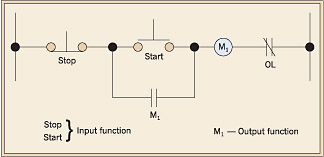

PLC operation is a function of these inputs and outputs. In the standard 3-wire control circuit, as shown in Fig. 1 on page 18, you'll notice a normally closed (N.C.) momentary stop push button, and a normally open (N.O.) momentary start push button. These contact devices represent the input function. The coil of the magnetic motor starter represents the output function.
The N.O. start push button energizes the coil of the magnetic motor starter, and the N.C. stop push button de-energizes it. Here, the PLC recognizes two input functions, which are the stop and start push buttons, and one output function, which is the coil of the magnetic motor starter.
