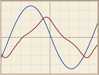

While energy usage is certainly important from a cost perspective, the power signature of lighting systems is equally important, but from an electromagnetic compatibility standpoint. Older fluorescent lighting systems used ferroresonant ballasts, which were not extremely efficient. Also, the power factor of their current draw was often quite low. Figure 1 shows the current draw of a ferroresonant lighting system, where the displacement power factor is very low (roughly 0.4). On the other hand, the current distortion is only 19% THD.
