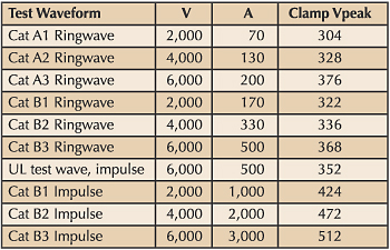

A Cat. C3, or service entrance event, has a maximum of 20,000V at 10,000A (high exposure). As we move into the building, the event lessens to Cat. B3 — a maximum of 6,000V at 500A (100 kHz ringwave). At the wall outlet, the value is 6,000V at 200A (100 kHz ringwave).
Don't let clamp voltage numbers fool you — you must match this specification to the load. ANSI/IEEE C62.41 lists and describes typical levels of transient current in today's facilities. What clamp voltage is acceptable? The Computer Business Equipment Manufacturers Association (CBEMA) has developed a standard of voltages required for stable operation of typical electronic equipment known as the CBEMA curve. From this curve, we know most modern electronic equipment can withstand a transient 20-µsec in duration, if that transient is five times greater than the nominal voltage. This is about a 848V peak on a 120V system:

The typical 150V MOV will turn on at 205V peak (at a test current of 1mA) and will clamp at the levels shown in the Table. At lower surge currents, the MOV will clamp within the acceptable range. But as current rises, this clamp voltage increases.
