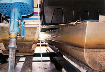

Photos of the boat show two conductors ostensibly emanating from the battery compartment at the stern of the boat and hanging in such a location that they could easily come in contact with the water (Photo 1 above). If these two conductors were connected to any of the boat batteries, then the necessary condition to facilitate stray current corrosion would exist as the direct current source from the batteries would be in relatively close proximity to the metallic hull. However, the photos showed no noticeable consumption of the aluminum hull in the proximity of the two conductors, so there's no foundation to suspect the presence of a stray current corrosion condition. But more importantly, the connection of these two conductors was never established.
