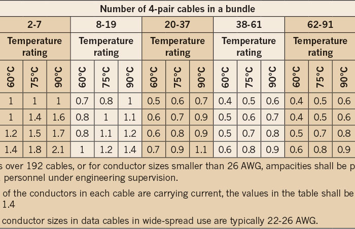

The National Fire Protection Association (NFPA) now addresses PoE in its most recent edition of the National Electrical Code (NEC). Table 725.144 of the 2017 NEC presents the ampacities of each conductor in 4-pair Class 2 or Class 3 data cables based on copper conductors at an ambient temperature of 30°C (86°F) with all conductors in all cables carrying current.
Since the NEC deals with conductor heating by the use of ampacity tables, the first option in determining a suitable cable type for PoE is to consult the ampacity table in Sec. 725.144 (see the Table). This Table recognizes the relationship between AWG size, bundle size, and the temperature rating to determine the current-carrying capacity of the cable. For example, a cable with 23 AWG conductors and rated for 75°C can accommodate 0.7A in a bundle up to 91 cables.
The 2017 Edition of the Code makes clear that data/com cable must have a temperature rating of at least 60°C (140°F) as mentioned above, and have the temperature rating marked on the cable jacket if the rating exceeds 60°C [Sec. 840.160]. The 2017 NEC also introduces another classification: limited power (LP) cables (the cable legend to include “…CMP-LP(O x A).” The LP cable marking is a new and entirely optional cable designation for communications cables, and the designation means that the cable can carry the marked current for each conductor without exceeding the temperature rating of the cable. LP cable uses TSB-184-A to determine bundle size. If a cable project is designed for a Type 4 PoE installation, an LP-listed cable rated for at least 0.5A should be used.
