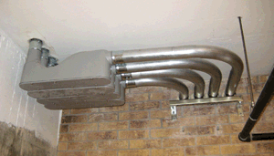

On a large renovation project of a seven-story apartment building, the owner engaged a construction management firm, which, in turn, bid out the electrical and telecommunications work separately. The electrical contractor that installed the low-voltage pathways was unaware that an offset in the conduit constituted a 90° bend. This was a problem, because low-voltage conduits are only allowed two 90° bends, according to the referenced standards and guidelines for the project. During the low-voltage supervisor’s initial site visit during construction, he immediately noticed the offsets. The electrical contractor was likely responsible for fixing all of those conduit runs or installing additional pullboxes in order to meet the contract documents.
Use of Smart LB conduit body allows a 90-degree
bend when there is not enough space for the long
radius sweep.

  • The TDMM allows the use of special communications LB to make sharp 90° turns where there is not enough space to make the appropriate bend in the conduit (see Photo above). The new 12th edition also lists other special conduit bodies.
