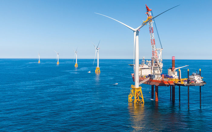

Last summer, crews installed the final blade at the Block Island Wind Farm, the first offshore wind farm in the United States (Photo courtesy of Deepwater Wind).
