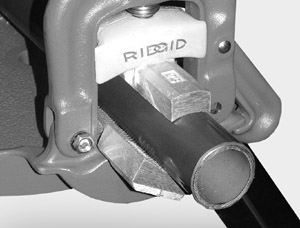

Clamping
Various manufacturers offer modified jaws for use in standard vises to protect the coating while it's held in place for cutting and threading operations (Fig. 1). When using a jaw or chain type vise, you can also use half-shell clamps to protect the PVC-coated conduit. These are available as a manufactured product, or you can make your own set in the field from rigid metal conduit (RMC).
To make your own half-shell clamps, follow these simple guidelines. First, cut two 6-inch pieces of standard RMC one trade size larger than the PVC-coated conduit to be clamped. Next, use a band saw to cut the 6-inch conduit sections lengthwise. Make the cut slightly off center. This creates two half shells — one smaller than the other. Then discard the larger pieces and deburr any sharp edges. Properly made clamping sleeves will have a gap between the two pieces when positioned on the PVC-coated conduit (Fig. 2).
As a last resort, if you don't have access to a manufactured set of clamps and proper tooling isn't available to make your own set, then wrap the area of the conduit to be clamped with sandpaper, emery cloth, or cardboard. The coarse side of the emery cloth or sandpaper should face the PVC coating. Note: This is the least desirable method and should be avoided if possible.
