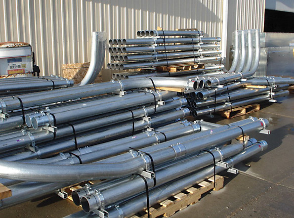

Pre-bending conduit and arranging it on pallets for easy installation on the job site is a great use of prefab techniques.
