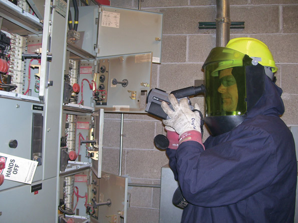

Infrared testing being performed by a risk management technician. Proper electrical PPE is being worn to prevent potential burn injuries associated with an arc flash event.
