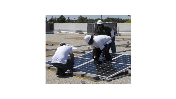

These solar panels are being connected to a ballast-type racking system on a commercial rooftop.
department. Then, this equipment is typically installed and maintained by companies that specialize in solar. However, general electricians are often called upon after the fact to work on the related wiring of these systems as part of a service call or renovation request.
