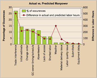

MCA's research has shown that the No. 1 cause of failure to comply with the short-term schedule is trade interference (Fig. 2). However, the most-heard complaint from the field is that the materials are not available — a result of working on Plan D instead of Plan A or B.
