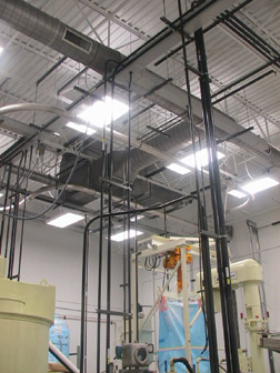

For most wiring installations, conduit remains the first choice. One reason for this reality is the fact that conduit's broad range of design types includes rigid metal conduit (RMC), electrical metallic tubing (EMT), intermediate metal conduit (IMC), rigid PVC, flexible PVC, flexible MC (metal clad in aluminum or steel), liquid-tight, and zinc-coated corrosion-resistant steel (Photo 1).

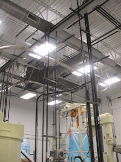

One factor that is increasing interest in cable tray is the increased commercial use of metal-clad (MC) cable. According to one executive at a leading wire and cable manufacturer, “MC is becoming the product of choice for commercial electrical wiring systems. The driver behind this shift is the ease of installing MC, saving up to 50% when compared to a pipe and wire installation.”
Since installed MC is frequently supported by a cable tray system, this trend bodes well for continued increases in cable tray use (Photo 2).
